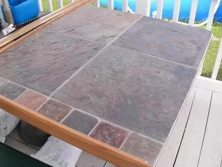

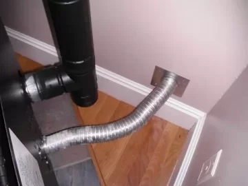

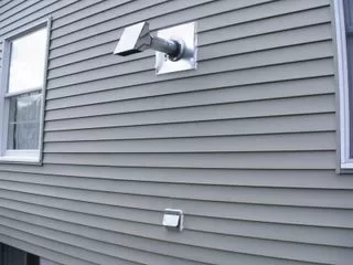

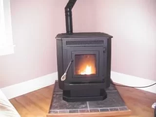

It depends on what the installer has to offer in their package. I was quoted $800-$1000 and we wouldn't have to purchase a thing (stove pipe, sealant, pad included). Though it was pretty nerve wracking when you go to cut holes through the side of your house. We did it ourselves and had to buy:
reciprocating saw $90
some high temp sealant $12ish
vent pipe $239
made my own pellet pad $60
painted the stove pipe black w/high temp stove paint $12ish
Pics attached.
