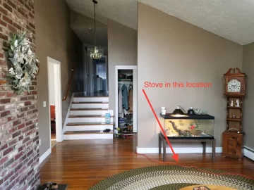

I got my first quote in for an install of a free standing stove.

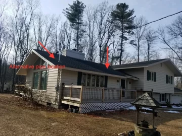

The guy told me that he can't cut through the roof, so we would have to go through the wall.
I've attached a couple of photos of the room and the roof location. The quote seems pretty high to me.
The install, including the chimney, hearth pad, and piping came to $4,250 and I buy the stove separately. The big ticket item was the cost of the class A chimney at $2,975. Even if we had to go two feet above our existing chimney, we would need about 16' of chimney at the most.
I am getting more estimates from others who would be able to go through our roof for the install in our preferred location.
Anyone have an idea at what I should be looking at for an install quote? Anything wrong with me just buying DuraVent chimney at Lowes for a third of that price? Anyone see anything wrong with my proposed stove placement? My wife's pet lizard would be moved of course.

May want to check your local code. Not sure about that wall location above a deck.
Talk to your local inspector for who they recommend. Most contractors add a % to the supplies and don't like it when the homeowner buys stuff..

Thank you. The location near the door would be through the roof The alternative location would be through the wall along the side of the house. My markup does look like it would pop out over the deck though
I would find someone who will go through the roof I see no reason that couldn't be done and it will be cheaper. And yes his price is high.

I guess the installer who provided the quote just doesn't do through the roof installs. Only through walls. I had another installer tell me he could do it. He's coming out this weekend to check it out.
That is odd. I try to push people to through the roof when possible.

Go straight up if you have the option. You won’t regret it. Draft will be better since you will have a chimney that is probably on the short side of the recommenced height range for the stove.
