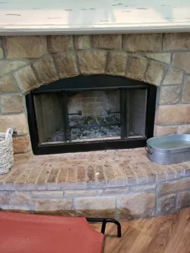

Seems a bit high for the chimney installation if this was for a freestanding stove, but we would need to see the particular details. Was there a hearth also included in the bid? Can you post a picture of the current heatilator fireplace?
Get some competitive quotes. Here is where to find certified sweeps that can do the job: www.csia.org
Thank you, here's a pic. I'll see if I can contact someone through that website - thanks again...

That looks like a masonry fireplace. Unless there are complication in the flue like an offset or narrow throat tiles, I would expect a liner install to run about $1600-2000? Is this a 2 story chimney or is it extra tall?
I am a little green to all this so I do appreciate the help. I think the inner walls to that might be made to look like a mason fireplace-maybe?
I can move the walls where the back wall and sides meet; around. Seemed strange to me.
Yes we do have a two story the chimney go up next to the outer wall and out the beginning pitch of the roof. I doesn't go through the 2nd floor, kind of right next to it in an attic area. But probably extra tall for sure.
That’s interesting. Never seen a rig like that.
Insulated liners usually run $1300 - $1800 around here, depending on height and installer, so your quote sounds high, but there may be good reasons for that. As begreen said, talking to other sweeps will help you narrow in on that, but having pricing already from two vendors indicates there must be some reason for it.
