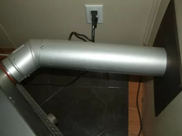

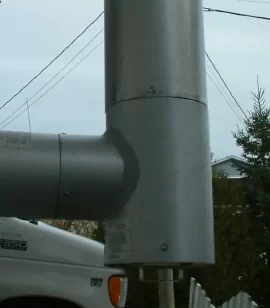

I would have him install it like this.You don't want to see that ugly pipe sticking up inside.
I also went with my dealers instructions after showing him a pic of the install area.He suggested i go straight out the wall, as to not put the pipe thru the ceiling and thru the upstairs bedroom, unless i was willing to sheet-rock it in , and put an ice breaker behind the flu as it exited the steel roofing,.
So i opted for install #2 which was straight out the wall with a 45 elbow, and 24inch double wall pipe,into a 3 to 4" T with Cleanout, then 3 sections of 4" for a total of 12 ft height, and a cap on top.Seems to work fine and came out exactly far enough to clear my 12 inch soffit and fascia board.May not be prettiest or neatest being 12 inches from siding, but eliminated cutting a hole thru the soffit/Roof,and he said will not discolor the siding with soot/Heat.
