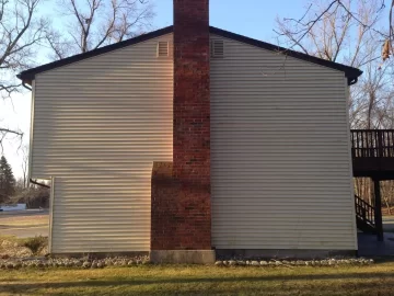

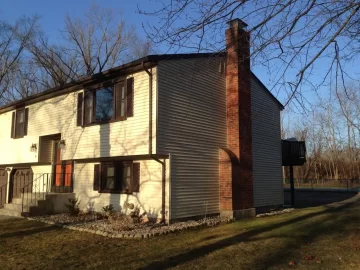

I have decided to go with a Harman XXV free standing cast iron pellet stove. I have a raised ranch and am planning on venting it directly out the wall on the 2nd floor. In the fall time the leaves from my neighbors house blow into my yard (on the side of the house I am putting the stove). I would assume that in the winter the wind would blow the same way so I am concerned about the side of my house being discolored from soot. Maybe I am overthinking this however I wanted to see what you guys think.
My house is a light tan/yellow color and the installer said he can do the install straight out 1-2ft for $675 (code is 1ft). He also said if I want he can go out and up to the roofline for $900. IF he were to go directly out and I wanted him to come back to go out (due to soot) and up to the roofline it would be an additional $350 for labor and piping.
If I did end up going out and up I am sure it would be MUCH harder to clean each year. I have added a couple pictures below, the stove pipe would probably come out between the attic vent on the left and the hump on the left side of the chimney.
What route would you go? Does your pellet stove (Harman) put off soot and discolor your house? Do they burn alot cleaner and am I overthinking this?

I was not sure what Harman suggested as far as the verticle limit. Now that I know it is 4ft I will probably just go straight out and have a cap at the end facing at an angle downward as soon on most setups. I do understand what you are saying about the T then up however with that setup I think that it would look terrible and have a higher chance of soot on the house. Do you have a picture you can post of your setup?
I am comfortable with cleaning the pipe and being on a ladder that is not an issue. The issue would be IF the pipe went up to the roof line (6-8ft) up I am not sure I could clean the entire piping well even even with a T at the bottom.

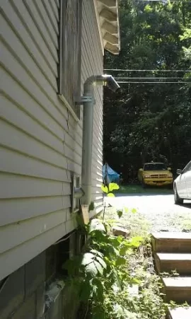

OK. The freekin rain has stopped I got a pic of the venting on my P43. Contrary to what Don2222 says, & with all respect to his opinion, I clean this baby every 3 weeks & the venting has yet to be an issue. Only minor buildup with the run outside...

thank you everyone for your input. After looking into this I think I am going to just come out 1-2ft out of the house with a slight bend down. I am going to however look into this OAK adapter. What do they normally cost?

After talking with the place that is going to install the stove (same place I am buying it from) they are going to put two T fittings inside the house. This will allow me to clean the stove on the inside and NOT have to get up on a ladder on the outside. They will also be putting a "jet cap" on the outside which will push the exhaust out further. Prob solved
