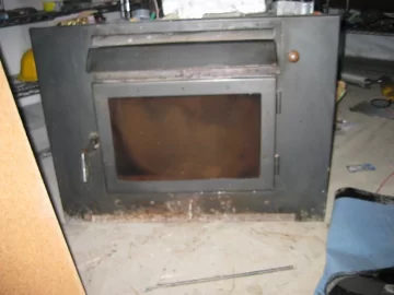

I'm not sure what it is called, but this is an older wood burning insert. Here is a picture.

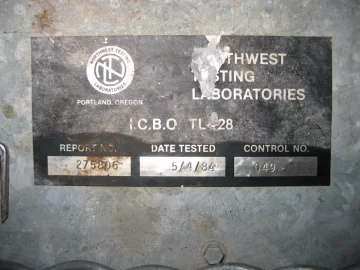

Not sure what kind of stove it is but I've posted photos of it below. This is for construction of a whole new hearth and stove surround, it is not going into an existing fireplace.
Insert needs to be in a masonry or approved zero clearance fireplace, it can not be free standing unless it was designed to do that with legs.
Now a cooking surface would be like this Napoleon's top, but the insert as you see is inside the fireplace.
Most go with a free standing stove if they want to cook on it regularly.

Darn it! Wish we could buy the one in the photo you posted but we are on a pretty tight budget. We may just have to come up with the money to buy a used free standing because cooking on it would be a huge plus! Is there a way to add a ledge on the front?My husband has a welder and some experience welding.
Thank you for your advice.
The insert in mellow's picture won't help you much either because it sounds like you don't have a fireplace yet and that is needed to install an insert. I really think you should go for a freestanding stove which will make cooking on top of it much easier. A new Englander or Drolet stove can be found for ~$900 and when you do the install and the chimney yourself you can get away with about $2000 for a new stove and a save installation. If you cut your own wood, your fuel savings will pay for the stove and pipe within 2 to 3 years most likely.
