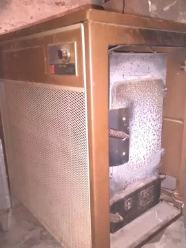

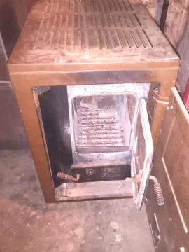

Attached are some photos of the wood stove that I plan to install.

Seems to me like marine stoves would suit this application, pretty well. They're designed for installation in similar confined cabins, with short chimneys.
