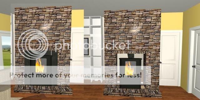

The flanges look good if I could find a stove like this. Looks like a European model.
OK, I'm with you now. Pictures really help. What you are calling flanges are normally called the surround for an insert.
If you build the wall out of entirely non-combustible materials (steel studs, durock, stone veneer) then the right hand pic would be possible if blessed by the stove mfg. Not sure about that top clearance though. It may be a no-go. But it won't look like that stove unless you are willing to spend more. How large an area will the stove actually be heating?
