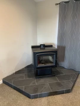

I have the stove set about where we want it. I will end up with 6" corner clearance (spec is 4") 30" or so front clearance, and over 8" side to combustibles (the curtain)

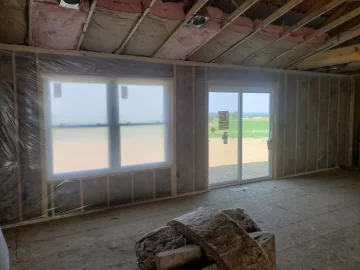

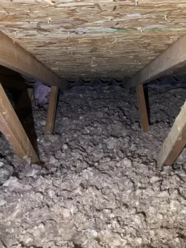

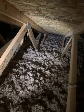

My question is how in the world do i get my butt down the roof joist to build frame work for the duraplus support box?! I'm only going to be about 2 feet off the soffit side. I'm about 8 feet away from where i need to get to in the pictures. I will have to go through 2 layers of insulation as you can see from when the house was built, along with 12" plus of blown in insulation. I don't see how i can crawl into the area from the attic space, so do i try and frame it from below after I cut the hole? I don't see any other way. Also, is there a prefab cover for the square support boxes, or do i need to fab one? I don't need mice or other critters getting in there!

Frame it from below. We will cut the hole in the roof most of the time so a helper can assist from above. Since you don’t have room for an attic insulation shield, we would use a fire stop to seal off the box. You can also make one from sheet metal.
I was wondering if they could use a tall (24'?) cathedral ceiling support box to act as firestop and attic insulation shield. It would go right up through the roof.

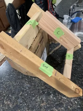

Before I go poking a hole in the ceiling, is this the correct way to frame for the chimney support box above the cathedral? Trusses are 24” apart. Run two studs (a and b) from truss to truss and make sure they’re level and plumb, then take piece c (x2) and cut to match that angle to drop in and screw to my studs? Thanks
That's one way, but it can also be flanged on the roof by folding down the bottom and side edges. Or a combo of both.
