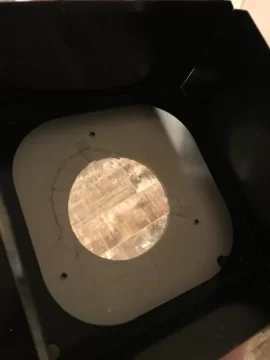

Question for those of you that might have a Harman Wall Thimble.. Does the white "pad" come out before installing or is that a filter/ insulator?
I picked one up and plan on installing the new stove in the morning and as I am looking over I realized there is no instruction booklet and am not sure if that comes out or stays in.
Thanks for any tips on whether this is a air filter/ insulator or if that needs to come out.

Don't remember seeing one like that - but it should come out.
Reactions: Swed
Its actually the Harman part number 1-00-677177 Thanks, I will pop it out.
Oh, that is the weird shaped one. Looks kid of cool though
