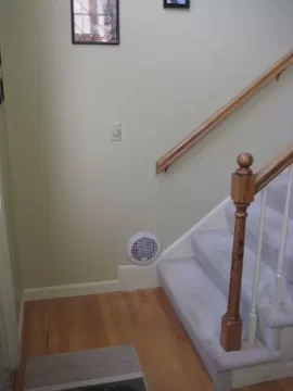

Excellent advice on the "peek hole". I like my thruwall. I needed to move hot air so mines mounted high, & I utilize a 6" fan on the floor of a 23' long hall to return cold floor air.

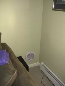

Good news, no wire. I am almost done cutting the holes. Just have to get the second one lined up perfect so the sleeves fit. (Read pain in butt)
Then I will clean up and mount the 2 halves.
It did end up a little farther over then I wanted but I forgot the foyer corner is not the same as the living room. No biggie it will fit! Everything I do is like that....it get's done but there is always something I forget! lol
Ok all installed and ready for a fire! The second side to cut was soooo close to some trim/ step but it just made it.
Thanks for all your help. A review of the air handling to follow.

Mine is high in the stove alcove (Photos above) to move heat as you mention. On its own, set to low, it raises the heat in the rest house to within 4 degrees of the stove room. That's basically what I do during this time of year. As the season progresses I'll place a 6" fan on the floor of the hall (20+ feet) leading to the stove room and temps in the rest of the house will be within 2 degrees of the stove room. At times when we're in the low twenties or teens I turn the thruwall on high and still maintain the 2 degree diferential. Without the "Return air" fan on the hall floor the thruwall helps, but it really shines when I actively return cool floor air to the stove room.
As to noise, I made certain I securely mounted the thruwall to reduce vibrations to a bare minimum. On low, I really don't notice it in the stove room which is 26X26 and where the TV is so it's where we spend the most time. There are several pieces of soft furniture in this space which helps absorb ambient sound. On high, yes I notice the fan noise in the room. It certainly isn't unbearable, but borders on the annoying.
My stove room is accessed only by the 20' hallway, so moving floor air alone simply wasn't acceptable (I tried). The thruwall mounted high was the obvious solution for me. It works wonderfully & when this one wears out, I'll install another immediately.

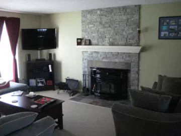

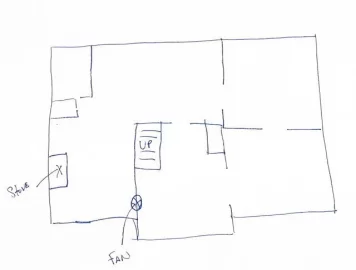

I installed mine to move cold air into the stove room, so the warm air moves to replace it. Last night I burned a pretty hot fire and I was very warm (74+) in there and it stayed comfortably warm in the rest of the downstairs (69+). I read here that it is easier and move effective to move the cold air than the hot air.
Below I have a diagram of how I am moving the air, the fan itself and the stove room to get some point of reference.
