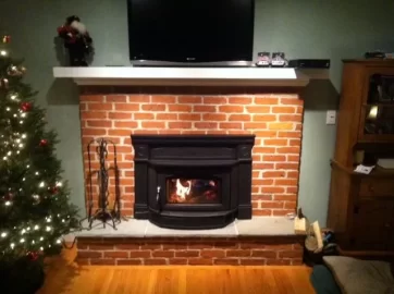

I put roxul above the plate and around the top of the chimney. Everything went smooth. Liner was was easier than I thought, only hard part was I didn't leave a lot of room to work between the block off plate and the stove.
Only one major issue an hour after running the stove . The furnace puffed smoke in the house from lack of oxygen ( last year I had blown insulation put in the basement ) I grabbed the shop vac and went right to th furnace clean out and I cracked a window in the room with the stove. I will post pictures in the am.
Is the stove in the basement with the Furnase? I can't see how the wood stove would be stealing air for the furnace if they are on diffent floors...
I had Foam Insuation sprayed in down there it is very air tight, and the furnace flue was full of soot. I think the two combined with wood stove running made a poor draft situation. I cleaned the furnace flue and cracked a window in the room with the stove. Issue solved

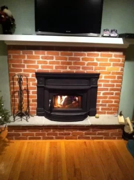

It looks like your installation came out looking quite nice. What are your plans for a hearth extension? It's only a matter of time before you end up with coals or a piece of a log falling out and onto your beautiful looking hardwood floor? Code usually calls for 16" - 18" of non-combustible material at the minimum in front of an insert like yours. When I had similar set up like yours I had a hearth rug in front of my raised heath and each burning season I'd end up with several burns on the rug from stray embers that came out while loading a hot stove. Good luck with your burning.
Thinking of buying a stove rug today, other idea is making a tile heath extention on hardibacker and or dura rock, I have extra of both from previos projects.... And Yes that is the last year i will have a tree in that spot
That is a very nice looking insert! I hope that is a fake tree that close to the insert though. One spark out the open door and the freight train sound would begin...HA-woosh! My father was a firefighter and he would never let us get a real tree when I was growing up. Now, I get real xmas trees but I keep it away from my insert.
Great looking stove. Just noticed the mantle looks to be made of wood. I can tell you from experience, this stove will heat up the brick face and there will be a lot of heat hitting that mantle. I strongly suggest you get that out and replace with a stone mantle. Just a safty measure, that's all.
Also, what Nick said about the extension, you should plan on something soon. I had a very similar install where the hearth wasn't deep enough. I put a wool rug down onto the hardwood floor and then a peice of stone. This doesn't require any modifications to your floor and can be removed after burn season.
Happy buring and be safe.
The mantle is 6 in above the min clearance in the manual. I thought i was ok there. And I plan on getting a wool rug, but i have a feeling i am getting one for christmas.....speaking of that I moved the tree this morning.
