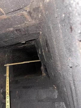

Q3 I’m not a chimney expert, but I THINK my chimney can accommodate a 8” chimney liner (firebox flue aside). I took some photos of the outside of my chimney, it looks like it turns a bit. But, given the measurements I took, would it seem as if the chimney would be big enough to instal 8”? My house was built in 1978 if that helps, though unsure if chimney was original.

The damper can be cut out and removed for more room. What is the inside dimensions of your clay tile? Also the liner should be insulated.

The damper area can be cut to clear the liner. You'll need an 8" insulated liner in that chimney. Looks like it will fit, including the liner. The corrugations on a decent liner are not an issue for a rotary cleaner like the Sooteater. Avoid 2 ply, smooth wall liners. If you want better quality get a medium-duty one. Rockford Chimney Supply has decent liners. Woodland sells Champion (Olympia) which is of pro quality. You can get their preinsulated liner for an easier install. If the liner that is purchased is directional pay attention to the correct install direction.

This is done all the time. If a notch is cut out of the damper to clear the liner, then a plate could be welded back in 20 yrs down the road, assuming open fireplace burning is permitted in 2040.

Cut the damper frame out nicely. Throw the part up on the smoke shelf it can be fixed later if need be. And yes stoves have come a very long way in the past 40 years.
