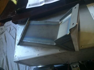

1. Remove original Air Intake flange
2. Screw in top and right side self tapping bolts to hold hew air adapter where orig flange was mounted

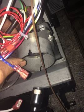

3. Must create new hole with self tapper on left side
This is not easy since room blower is in the way.
I found two choices here
a. Remove room blower to get self tapper straight on and screw in.
or
b. Drilll pilot hole on angle, the get sel tapper in

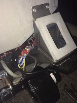

4. Drill two new holes to mount top of air adapter with self tapppers. this was staight forward.

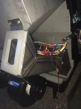

5. Mount 3" flange to P53i Frame for flex liner connection using white lytherm gasket supplied.

Pic 1 - Remove Old OEM flange
Pic 2 - Using self tapper supplied, Cutting a new hole with room blower in the way!

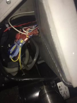

Pic 3 - New Rigid Air Adapter
Pic 4 - Mounted Air Adapter 1

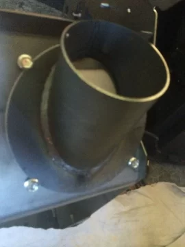

Pic 5 - Mounted Air Adapter 2

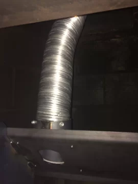

Pic 6 - 3" Fresh Air Falnge (Note flange can be rotated if liner comes down at angle!
Pic 7 - 3" Liner coming down to P52i Frame for fresh air for burning!
