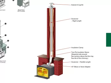

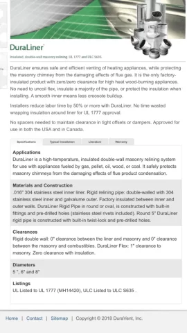

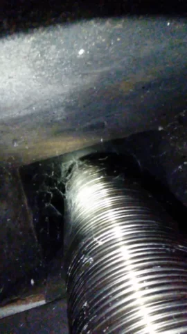

So from what you guys are saying this company who installed my liner did not install it to code because they used Duravent Duraliner that is double wall with insulation between the walls and the pipe says it's zero clearance, but the 60" flex was never insulated and when they flexed the pipe to the flue connector it was touching the side of the brick chimney towards the house side.
[Hearth.com] Insulate liner or not [Hearth.com] Insulate liner or not
View attachment 219943 View attachment 219944
Correct. Dura liner says in their instructions to insulate the flex section. And sell insulation kits for it.
