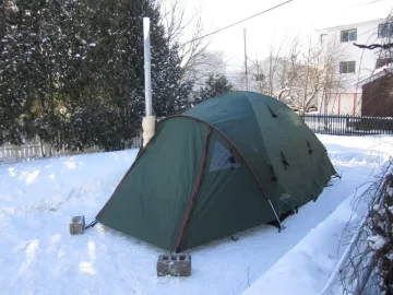

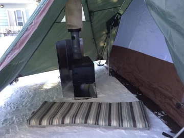

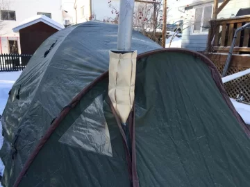

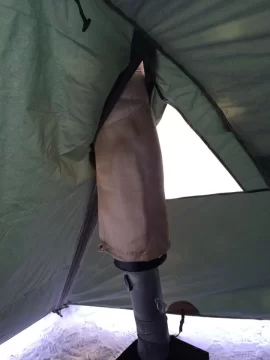

I'm running a 4" stovepipe through a 36" long insulated sleeve (6" inside an 8" black stovepipe) to exit a zippered door in a polyester tent fly and I'm looking for advice. The sleeve is capped at both ends with a 4" hole cut in each cap to allow the stovepipe through. I have mineral wool insulation in between the 8" and 6" stovepipes. I've wrapped the outside of the 8" sleeve with welding blanket so the tent material doesn't touch the pipe. This works to keep temps at the blanket down to 300F during a really hot dull red burn on the small sheepherder's stove.
Should I keep the existing set-up or remove the insulation and vent out the gaps between all the pipes by removing the caps? I know I'd lose heat up the gaps which I can live with if it would prevent the outer 8" pipe from getting too hot. Any advice and all opinions welcome.
