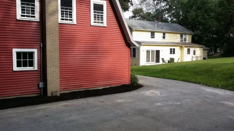

I have a concrete foundation, all of it sits off the ground before it hits the siding but in many places not much. But there are other areas where it almost touches the ground. Can mice climb up a concrete wall? How would I mouse-proof the bottom edge of the siding? The walls are also open on the inside so maybe there is a way I can seal the bottom of the wall.
Besides that there is no way in besides the doors.
Mice can jump, climb well, and fit through incredibly small holes. They can also chew through just about anything softer than metal including wood, foam, plastic, etc.
Sort of looks like this all around. How would I start mouse-proofing the bottom edge of the siding?
[Hearth.com] Insulating a barn but afraid of mice...
Inspect where the foundation meets the siding very closely. They can find little gaps to squeeze in. Find a material they dont like to chew to seal those gaps. I believe dow great stuff has a version made for pests which, maybe its bitter or something. Steel wool works, people use it in winter to block entry into their campers. Never used the mineral wool insulation for pest blocking, but it sounds like a good idea
