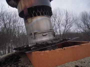

I had my stove installed last year and the installer did a lousy job. I wanted a block off plate and he claimed it was not necessary since it was to be insulated and sealed at the top. Well a year later I find that he did not even seal the top and my chimney cap got clogged (see image). I can only imagine how much heat is being lost and how the top of the chimney is too cold and creating creosote. Well I got really pissed and he is saying he will come out and fix the cap. I am planning on having him install one like Brother Bart recommends (see below the top is hinged and can be easily opened for cleaning). But reading more I see how many people recommend having the pipe insulated.
Since the pipe is already installed could I just have the top several feet insulated when the cap is being installed? I really do not like the idea of pouring in a liquid to permantley alter the chimney. My chimney is terra cota lined. It is probably close to 30 feet tall. Should I go to the hassle of trying to have the whole pipe removed and insulated?

I had a similiar experience. I removed it all, insulated and installed a block off plate. Your cap is fine. Just make sure it holds tight. There is a world of difference with the insulation and a block off plate. The plate is not needed, just an extra measure of safety. I can tell you the two changed my insert dramatically. I used to be able to damper if off down to 1/4. Now I can choke it down all the way and get longer burns and clean glass. Absolutely do it!
X2 what burntime said, but I'd go with the cap like BB suggested. It will secure better to the clay tile and offers several overall advantages IMO.
Love those caps. And as to the insulation, give what I did a try and see how it works before going for fully insulated. Mine are packed with Rockwool down to about four or five feet from the top. In five years and a bunch of wood burning the draft is like a Hoover in both and accumulation is negligible. I sweep'em but sometimes I think it is just because I have dragged the stuff up there with me anyway.

Must be the picture, the chimney top is a good 5 feet above the shingles and a 32 foot ladder will not reach the top, so it is a bit scary for me up there with a extreme pitched roof.
