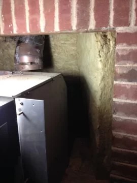

Bought mine at Lowes. I insulated behind the insert also. It made a significant difference.
