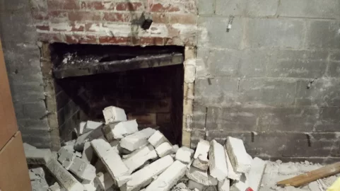

I read many posts on hearth.com for years in anticipation of doing this upgrade. I have an older Fireplace in the basement. I want to install a Century high efficiency wood stove. However, before I install it, I want to insulate the wall it is in. The wall is a below grade exterior CMU (cinder block) wall. I want to install 1" rigid foam on the CMU, then frame it, fill the voids with R-13 for a total of R-18 and finish with drywall on the sides and/or Durarock above the stove. Can this be done safely and by code? If it can, this will extend the wall by 5". What do I need to do to make up this 5" from the old fire box? Picture #1 is what I have. Picture#2 is how I plan to insulate and frame. Picture #3 is what I want it to look like when I am done.

Ok, I'm not sure which "brick" your referring to. i assume you mean the regular red brick above the fireplace. Secondly, If I insulate that wall by the time I have the drywall on, it will protrude 5" past the current fireplace. So the wood stove will be recessed. .......not good. Can I mortar an additional fire brick row along the outside edge where the current firebrick ends?
If you are installing a freestanding stove you just need to honor all of the clearance requirements of that stove the fire box doesn't really matter unless you are doing an insert. So check the clearances of the stove you are going to be using

Ah, the original post said wood stove. An insert is a different case entirely. In this case one needs to pay attention to mantel clearances too. If the plan is to cover the cement block with stone, then I'd leave off the insulation for that section and just mortar the stone to the block.
Be sure to have that fireplace and flue are cleaned and inspected by a certified sweep or mason first.
yes like begreen said an insert is a totally different animal. The fireplace needs to be built to code like it was going to be used as a fireplace then mantle clearance required by the insert needs to be met here is a link for proper fireplace construction
http://www.rumford.com/code/clearances.html
