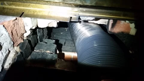

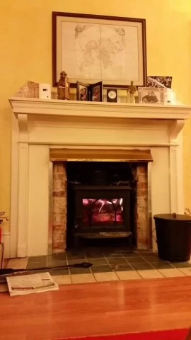

My question: I have an insulated liner that goes up through a clay flue, but I must be losing a bunch of heat around the liner. I went to the chimney shop where I bought my stove, and the guy said to buy some fiberglass insulation from Home Depot to stuff around it (leaving a 1" gap around the liner itself). I read some posts on the forum here that made me question this advice. What are your thoughts? I've posted a couple photos below.

Roxul insulation on top of a block-off plate will help keep more heat in the room.
Some questions first... I don't see where the liner comes up above the masonry in the first pic or is the pic an old one? If it's just a before picture, is there a proper sealed top plate on there? When you said insulated liner did you mean uninsulated?
It is an uninsulated liner. There is a top plate. The picture inside the chimney is from the top of the stove looking UP. I've read up on several of the threads here and am proceeding with Roxul and a block-off plate. I found Roxul at Lowe's in a HUGE package (none at Home Depot). Did any of you find it in smaller quantities?
