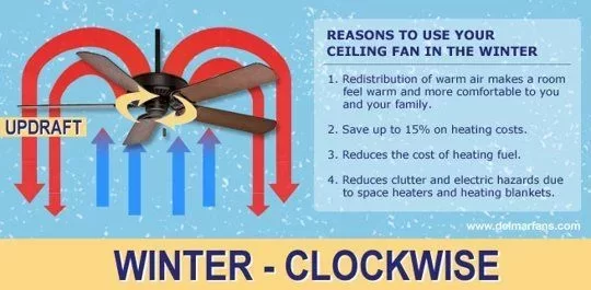

Your ceiling fan will not push hot air out of the room. Ceiling fans do next to nothing to move air horizontally. What they do very effectively is move air vertically. What you need to do is set the ceiling fan on slow or medium or whatever works for you, turning so that it is bringing cool room air up through the fan and out the top to spread in all directions along the ceiling and travel down the walls, and repeat. Do you know what a torus is? In case you don't, it's a donut shape. The ceiling fan will produce a donut shaped pattern of air movement in the room. The result is no thermal stratification and much more even distribution of warm air without any uncomfortable drafts to be felt. The warm air actually leaving the stove room will be minimal...ceiling fans don't do that. Rick
[Hearth.com] Insulation Questions
Image courtesy of the wonderful folks at Del Mar Fans & Lighting
http://www.delmarfans.com/educate/basics/what-is-the-proper-ceiling-fan-direction/

Thanks to All. I am already learning a lot form this site... Torus and ZC. Fan is now set to clockwise and on slow. I felt a breeze on Med so I assume that is too fast. My wife is in charge of curtains and the fashion decision hasn't been made. Blinds are all I am allowed for now.

Turn that ceiling fan on if your looking to keep the living room warmer. The moment I turned mine off the heat moved throughout the rest of the house (which is what i wanted) When I had it on it kept the living room much warmer
nevermind i see that you did that now. slow is the way to go too
I have one in every upstairs room. I keep the ones in the open/common areas running all the time. if I keep them on low and pulling the air up (not blowing down) it helps distribute the temps throughout the living room, dining room and kitchen. it also helps me keep that air moving and bringing more air up from the basement. and keep them on low. if I need more heat to the back bedrooms, it turn them on there too but most of the time they are around 67 degrees which is just right for me to sleep in. get some drapes and keep the fan on and I think you'll see a big improvement.
