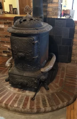

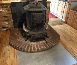

Here is a picture of my setup.

Is this stove used for most of the winter's heating or just used for supplemental heating? How much wood are you going through during your average burning season? Is your wood seasoned/dry? Why wouldn't you want to try a modern stove? You could burn less wood for the same amount of heat which means less work for you.

The stove is used for most of the winter heating. We have a hot water boiler with cast iron radiators as supplement and backup when we are away and not using the wood stove.
Main reason we have kept using this stove is no creosote buildup in chimney and sentimental reasons. My father bought the refurbished 1800's parlor stove in the late 1980's. Have been using it ever since to heat the house. Can fit a 26" log in the fire box. Easy to clean and remove ashes. Yes, it burns inneficiently, but I never have to go up on my 1800's two story steel roof house in the winter and clean the chimney. Flue is always clean as a whistle.
I burn a mixture of hardwood, mostly red oak and black cherry. Also burn alot of box elder, as we have it everywhere on the farm.

A modern stove will burn cleaner. The only reason your getting no buildup now is all of the heat that is being wasted out the chimney carries the creosote with it.

How much heat do you lose with a pre epa wood burning stove, would you say 50 percent?
It depends on the stove. An old one like this I would guess is 20 maybe 30% to the 80% ones of today
Reactions: Itslay90
Damn, people need to stop wasting wood, and get a modern stove
But there are some stoves that were far more efficient than this one made pre epa though
Do you know any ?
Vermont castings were much better. Cawley Lemay had some very efficient ones at the time. Earthstove had some early secondary combustion ones. I am sure there were others

One of these Woodstock Absolute Steel hybrid wood stoves would look nice on your round hearth.

Ya, the absolute steel is a hit or miss on looks either way. I worked as a science teacher for a while on the Navajo Indian reservation so I kind of have a soft spot for those and the Navajo stove.
