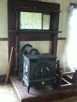

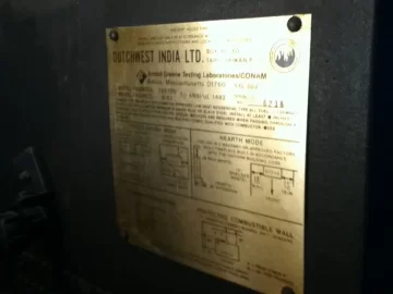

I have not had the chimney and wood stove inspected yet. A heating/cooling guy will be over tomorrow to try to sell us his product. Not sure what that is yet. The wood stove is a 30 year old Dutchwest India Federal Airtight. These things should last forever right? ...Or would you recommend replacing it? It sticks out really far from the wall I'm sure because of the woodwork around the chimney hazard. It would be nice to find a wood stove that fits in the fireplace or maybe put the wood stove in the basement.

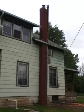

Here are a few images. How could I get to the top of the chimney to clean it annually? Could I lean a ladder against a chimney that sticks up that high or would I have to get scaffolding? The pipe that is running up beside the chimney is a vent to a water boiler furnace that is in the basement. This furnace has not worked in over seven years. There is water baseboard heat in every room of the house that does not work. I'm assuming the furnace guy will recommend for us to pull the furnace and baseboard units out.

Well you should not have to pull the baseboards as well as the furnace unless water froze in the baseboards. But if you have nat gas i would put in a nat gas furnace for sure. That stove is ok but not great more than lickley it will need a cat and you should have the whole setup inspected. It is hard to tell what is going on there but i can tell you for sure that you have a clearance issue from the pipe to that mantle.
Hmmm...there are a handful of things a new stove would do for you.
reduce wood consumption (even thought the old stove is a cat stove).
reduce some of the crazy clearance issues you are dealing with
(and this is a personal opinion) give a cleaner fit and finish to the install.
Get a set of pro eyes on this setup to see what you are dealing with. Installing a liner may end up being your best option.
Well after seeing what for stove you have it may be alright to use. May need a new cat but hey.
Flue setup has at least one issue or three.

As Jags brought up, there are clearance issues and the hearth is definitely inadequate. Unfortunately the chimney height may be inadequate for some modern stoves. That will narrow the choices.
