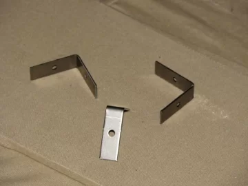

Some of the Lopi inserts do not have a collar that rises, just a hole in the top, but in the package somewhere, there are a few little angle brackets that you'll secure to the stove and then secure to the flex/liner to keep it from pulling out when you sweep. I can't remember if your stove has a bypass in the flue collar, if so, just notch your connector to fit over the rod and drop it in.
That what those pieces were for. It does have the bypass and notice it did hit on it. I'll give that a try. Thanks for the information.

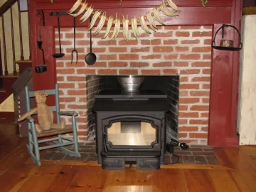

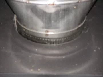

O.K. so I made a notch in the pipe and it fits better. Now I don't see anywhere to attach the brackets. Also am I suppose to seal around the pipe? If so with what. I've attached some pictures. Appreciate any responses.....

OK, you'll use some self-drilling screws or drill some holes and use sheet metal screws to attach the brackets to the stove AND pipe. You should not need to use any sealant around the pipe, if your chimney is operating properly, it shouldn't smoke out at all. However, if the fit is abnormally loose, you may push some gasket in around the pipe, just so that when you sweep the chimney liner, it doesn't puff ash out from around the connection, and I only suggest this for an insert, because you can't as easily just vacuum it up. Lookin good!
Hope you are going to paint that stove connector.Looks good :lol:

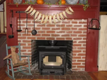

The notches did it, and once I could push it in all the way, it felt tight. No need to put a gasket. Just got back from my daughters soccer game and it's cold, looks like I got this set up just in time.
P.S. I put a coat of paint on the connecter pipe, looks better especially since the wife doesn't want me to put the panels around it.
