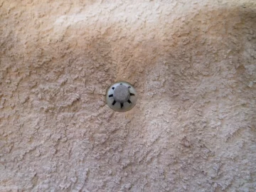

The gasket on the lower cast iron plate needs to be replaced. I bought one, but didn't know it was held on by two one-way clips. Has anyone had any luck getting them off or do you just cut them and buy new ones?? I don't recall seeing them on the parts listing. They look like the clips on tricycle wheels that you pound on and once on, don't come off. Help please

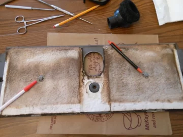

Here is a picture of the clip that holds the lower cast iron plate gasket. There are two clips, one on each side. Second picture is of the old one from farther away, and you can see the center area is damaged.

If you look at the second picture, you will see a hemostat pliars. I grabbed the clip with those and gently twisted back and forth, and the clips came off. They aren't a tight fit like I thought. I measured the gasket material and it is 1/4" but must be hight temp or asbestos because it doesn't melt. I found the gasket for $36 at Mountain View Hearth Products. They also have a gasket kit which has the lower cast iron gasket, the combustion motor gasket and the temp switch gasket. It's called the annual cleaning gasket kit. My stove is back in operation.

Yes, the gasket was not glued on, just held on with the two clips. I damaged the center around the pellet drop shute opening so replaced it. The clips were not self destructing like the ones on a tricycle axle. They came off with a gentle twisting motion. Tell me how your gasket hunt went.

In the future, when removing the lower cast iron plate, it's very important to keep it "in place" while loosening the three allen head screws holding it. I made the mistake of allowing it to drop down when the last bolt was removed. This allows the drop tube to hit the gasket material and damage it. To paraphrase the job, "remove the two outside screws, and then hold the plate up with one hand, and remove the center screw. Carefully pull the lower cast iron plate straight back to clear the gasket before allowing it to drop down."
That's my take on it. The replacement gasket material was 1/4" thick and is not glued in. The OEM gasket had a smooth side which was against the lower cast iron plate, and a rough side which was facing out. The two clips, at least on mine, were easy to remove with the surgical tweezers shown in one of my pictures above and push back on using my fingers. Hope this helps others.
