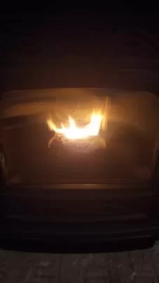

stove came with house had it moved from upstairs to the downstairs apartment called the local dealer to have stove moved the wanted a chimney guy come and clean and inspect that was all done paid a lot . have had issues with stove from get go called the local dealer next day after install because stove did not work after being treated very poorly by store manager he sent the same two that did move they said auger motor was bad so they replaced they also said docking gasket was no good but did not have one so i replaced it. still not working so i found another company they came out and found a dead bat in auger i asked about smoke he said you might get a little on start up it no has been running since 12/28 no lazy flame heating well the gaskets were all checked told to be ok i just am getting a little smoke from the sides and from the blower vent i will attach pictures

Can you be more exact? The picture doesn't show smoke. Your flame looks ok but low and that can be OK if it is now ramped up. Are you saying smoke is coming out of where the room distribution blower air comes out? The vents on the front where the warm air blows out?
If it's there then maybe something else climbed or some debris got in the air exchanger tubes and is back in there smoldering. Shine a flash light in and see if you see anything.
