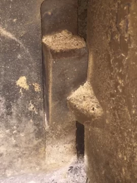

Do they look like wedges?
Do they look like this?

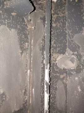

Hi sorry for late answer, but no they look like they are more of a metalpaste of some kind. From this picture you can see where they are located in the rear topleft area and that they look like they now are "broken" where my paint skills have marked :)
Im still having clear bright flames while in bypass mode, I can control it a bit since when I max out the airintake the fire gets stronger but I cannot get the flames to vanish by closing the airintake.
I have replaced the gasket for the door, I think it should be fine since I tested it with the dollarbill test but maybe that could still be where the stove gets to much air? Do you know what size the gasket for the door should be?

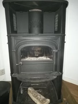

Can you verify the primary shutter is closing all the way? If it’s a cable system like my encore then the handle can open and close all the way but if there is an issue with the cable or shutter the primary air may not shut all the way. There could also be an obstruction preventing it from closing all the way. Another thing you can try is take a bright flashlight or shop light and put it in the stove at night (cold stove obviously) and see if you can find light escaping from any seams. Let’s see if we can get @defiant3 to chime in and give us some professional assistance.
Hi ok, I can try to see if the cable is obstructed in any way. I cannot really use the flashlight metod i think since my stove is built into what is called "the danica" cabinet
However i know that there is a Intrepid II installed in this cabinet, I will attach a picture since its over my head to explain this in english :) So the thing is i have this cabinet around the intrepid II which makes it harder to see if any leaks are there..
I got the manual for this as well, and the primary air is now adjusted with the controllever on the left side and this lever has a cable attached going on the backside of the stove (but still inside of the cabinet) to where this adjustment is usually handled in the right backside.
