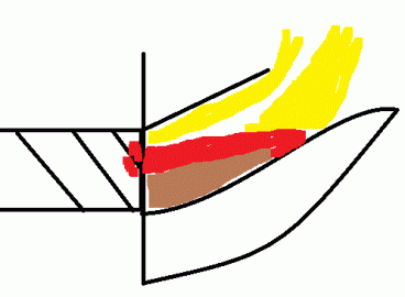

OK looks like that was only part of the Issue. I still see the flame crawl back to the auger and a CLEAR difference with the new seal for the hopper lid. I checked my gasket and fixed the area it was leaking. but its still burning back to the auger, it takes a lot more time but the majority of the flame looks to be coming from there instead of the leading edge of the burn pot. is this normal??? I am suspect of the glass gasket of the burn pot since when I took it off haft the gasket stayed on the pot the other in the stove but put back together would still be complete. I also noticed at the top of the hole for the auger on the burn pot there is a slit in the metal is this by design or is it just cracked from extensive heat from a dirty stove over a long period of time. what do you guys think?
I'll take some pics and post them tomorrow.
Ok no pictures flame was too bright to show what I am thinking is a problem. soo I used my wonderful artistic abillitys and MS Paint to make an illustration

With what you are describing it does seem like it may be normal, if I understand right. It sounds like you fixed the hopper lid leak... and the way to confirm that is burning with the lid closed.. and then open.. and observing a noticable change between the flame.
As for the burn pot... my experience is that flame should be coming from the back of the burnpot since the majority of the fuel is fed there and the deepest collection of pellets will stay there... in other words the collection of burning pellets vs ash should be from back to front Pellets then ash... If you have ash collecting against your auger during operation or are getting a layer of ash->pellets->ash then I'd be concerned. if its just Pellets right up against the auger burning like blazes and ash collecting on the ouside of your flame, then its normal as far as I'm concerned.
The only thing that I would question is if your feeder is working is too slow if you are not getting at least a good 3-4 inch wide collection of pellets burning when wide open. For me, wide open feed settings and stove temp mode up as high as it will go, I still don't lose pellets out the burnpot... I end up with an impressive 6" pile of pellets burning like crazy.. but it seems the more pellets that end up in the burn pot.. the more it will burn.

That is fantastic!!!!
Brown is unburnt, Red Hot pellets, yellow flame.. Is the Ash all collecting in the right of your drawing?.
yes exactly. ash is collecting at the end of the pot and not ontop of the pellets, i was just concerned about the burning of pellets going into the auger. I feel much more confident in the stove now. I was racking my brain trying to figure out what I missed. Thank you for the quick replys guys.
