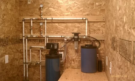

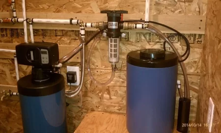

I chose to install a manganese oxide iron filter which uses no salt but I do need to throw in some bleach every week or so to prevent iron bacteria from sludging things up. This filter is the same thing I use in municipal water treatment for large scale manganese removal and not some kind of gimmick. See my photos. I bought my system at http://www.cleanwaterstore.com/iron-manganese-filters.html and have been very happy with the
performance. Self installed of course. In the photo you will see the little side chlorine tank for backwash and the screen to remove grit before the iron filter.

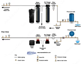

Looks like they recommend iron filter, sediment filter, and some softening. I haven't had a chance to take a good look at this yet.
I don't want to back-wash into my septic, so it looks like I may be in for another small tank and dry well in the yard.
[Hearth.com] Iron and Manganese in well water?
That sediment filter is just a screeen to protect downstream equipment from damage. Looks like they thought your ph was fine.
I agree to not send any of the backwash water to your septic. People that do that are making a mistake. I route my backwash water into the downspout system so it dumps to the surface.
I bet you could skip the softener for now if budget is tight.
Those air charge iron filters do require a daily backwash but no chemicals and are rated for 7ppm iron. The disposal of backwash water could be a problem if you dont have a space to dump it. It will be chemical free waste but could stain due to the collected iron.
