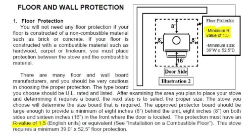

PS: Is the hearth up to the insulation requirement for the NC30?

Is the hearth insulated to the 30NC spec?

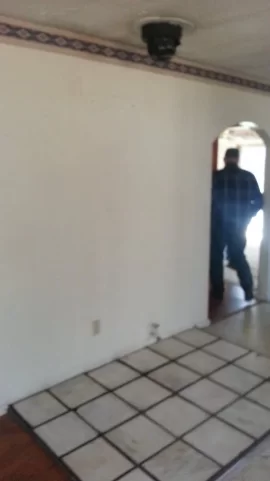

By hearth I meant that stand the stove goes on. Ive not heard of the spec you're asking about begreen

Page 8 of the manual has the hearth protection requirements. It needs to have at least an R=1.5 insulation value. The R value will be determined by the way the hearth was constructed. To reach R=1.5 it needs a layer of .5" micore or several layers of Durock NexGen under the tile.

The piping is already there, I will have the stove in place. That is what prompted the question. It seems like an incredibly easy job for someone that knows what he is doing. I just dont feel confident doing it myself yet.
this attachment is from englander, right? Where did you get it? I would like to see the whole thing
