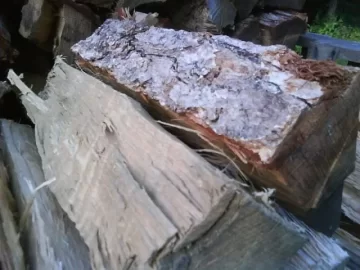

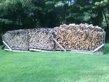

Start your 2010/2011 log splitting quest now, can you post some pics of the mystery "unidentified " wood?

Here are a couple of pics. First pic shows 3 separate bins connected, in the left 2 bins you see all white ash. The right bin I thought was ash as well but as you can see the color of the wood is a lot different.
2nd pic is of a few splits from the right bin.
