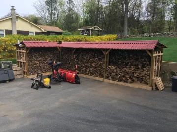

[Hearth.com] Is a wood shed sized to hold 1 season's worth? It all depends on your space, time constraints and shed design, I chose to make a long "L" shape shed that holds approx. 8 cords, each bin holds 2 cords and I burn a full bin at a time, since I only burn about 4 cords a year I can easily alternate back and forth in between seasons, its also peace of mind knowing that the shed is full, no tarps are needed and the wood is staying dry when we get a good summer t-storm.
I also keep a 4 cord stack on pallets (that's how I get my "3rd" year) and in the early spring i'll load that wood into the shed then start collecting again for the outdoor pallet stack.
