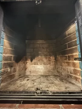

We bought a new house last year -- a 1920s bungalow in southeast Michigan -- and we'd like to install a wood-burning insert to supplement our primary heat source (heat pump) and to have as a primary heat source when the power goes out during winter storms. The problem: the existing firebox2 is super small! We've had two people come out to look at it, and both said it's too small for any wood-burning insert. As a result, we're thinking about extending the hearth a bit and placing a small wood-burning stove right in front of the fireplace. (We've talked about the Morso 1410 B, for instance.) I don't mind that solution, if that's all that's really possible, but I want to make sure I'm not missing anything.
Does that seem right -- that no wood-burning insert will fit? If so, how big a project is it to reshape the firebox? Is it even worth it (e.g., is a stand-alone stove better for our purposes)? I'm attaching a bunch of pictures. Happy to follow up with additional info. Thank you again!

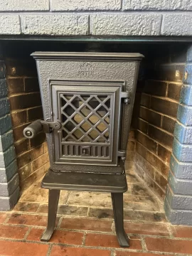

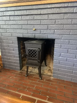

I'm not sure if anything would fit. We had the same issue with our fireplace. We ended up putting a wood stove on the hearth and love it. Also if the power does go out a woodstove will out preform an insert. Inserts rely on blowers to get all of the heat out in to the room. Without electricity they will heat a room, but not nearly as efficiently.

Look at the freestanding Jotul F35. It can rear vent and has a short leg kit for fireplaces.

It get the stove low enough for the the rear vent to fit under the opening. It can go as far back as you want it. I have one set all the way back but it really needs a blower.

The short leg kit will allow the stove to top vent directly to the liner or rear vent if it's desired to have it sit more into the room. A blower kit would be recommended along with having an insulated block-off plate sealing off the damper area.

I think the F35 with short legs would fit right nice. You will need to figure out where the outlet is when the stove is back where you want/can fit it. It might be such that you don’t need to rear rear vent it. Would save the cost of a T.
Pay attention to how the height for a rear vent is higher than the top. Read the cleaning process too

We let this slide last fall, but with winter looming again, we're back on it. We're getting a proposal for the F35. Thanks everyone for the help! While we look into that, I realize I forgot to ask: are there other freestanding stoves with short leg kits out there? Also: is there any real downside to a stove that sits partway in the fireplace opening (apart from aesthetic downsides in the eyes of some)?
If the fireplace is on an outside wall, you'll loose more heat to the outside.
A stove that radiAtes a lot of heat to the sides and back may not be ideal especially if you go far back into the fireplace. A stove with a convective jacket might be more efficient.
Insulate the fireplace with rockwool and e.g. a metal plate or durock in front (painted stove black).
Also add an insulated block off plate.
