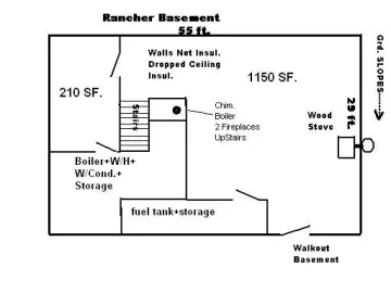

Sorry the basement layout didn't work, to large.
I did it in paint and don't know how to get the size down to fit.
The basement is55X29, The stove will be at the end, the room is L shaped, 1150sf.
The other room is at the other end of the basement, 210 sf.
The rest is storage, boiler w/heater, fuel tank and it is layed out strange.
The stairs are 40ft from the end wall, next to the 210 sf. room.
It's a walk out basement from the end corner.
Hope this helps

I'll try to post the sketch again.
Do you think the Englander 30-NC would be to large?

I think it is difficult to over size in an uninsulated basement - anything from 2 to 3.5 cubic feet should do you well - these is no need to get a bigger stove unless you have a bigger woodpile, because a stove does not product heat, it is the wood that does the job! All in all, burning a smaller stove hotter is usually more efficient, but the burn times will be shorter. I suggest weighing all those factors, and as much as I support many of the opinions given here, I certainly would not choose a stove based on anything that folks here say - in the end it is your personal decision.
