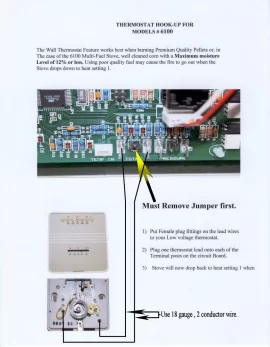

As far as the thermostat. The Thermostat recommended is a millivolt one. Connect the leads to the two post on the control board labeled T-Stat. The attached should help.
As far as operation; when the thermostat calls for heat the unit will ramp up to what ever preset HR it was on, when the thermostat is satisfied it will lower to the lowest setting and maintain a fire until the thermostat calls for heat again.

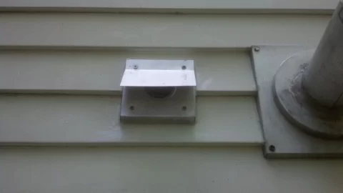

Outside view:
[Hearth.com] Is it possible to put a T-Stat on a 5502m Pellet Stove?

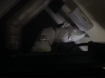

Inside view. You can see the wall plate.

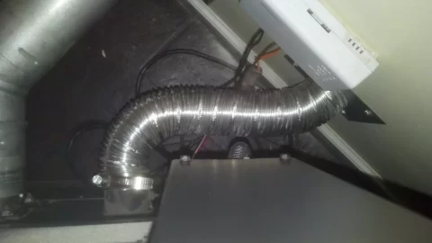

Inside view with OAK pipe insulated.
