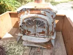

Is it worth it to blast and re-enamel a VC Resolute?
CindyG
Oct 26, 2010
4
Texas Hill Country
I have the opportunity to buy a Vermont Castings Resolute that is about as ugly as can be from surface rust. The owner sounds straight-forward and knowledgeable, and has told me that it is structurally very sound, no cracks or issues (he bought as is for a shop, but is now moving). He is asking $250. I don't know the age, but the enamel color is grey, which I don't believe is made these days. My question is: is this worth purchasing, finding someone to sandblast, and someone to re-enamel? I don't know of the efficiency nor cost of doing either, but I figure that I might get the unit I want, and save around $1000 over price of new. Any suggestions? Thanks much. Will attempt to include photo.

Greetings. Nope, I would only get an old stove if it was in primo condition or free. Considering you can get a new stove and a 30% tax credit on it + the cost of installation, I'd say pass for sure.

It will run you about $150-200 for a model that size to get it blasted. You can get an old, good condition, clean Resolute for that price.
I would pass on this one! $50.00 maybe.....but I would still think about it...
Thank you BeGreen, Diabel and BrowningBar. I will pass on this one and look into the new models suggested. There are not many second hand stoves offered in my area. Now air conditioners, on the othe hand.....

That guy may know his stove, but I would have some doubts about something that looks that abused anyway. If it really is sound, it might make someone a good camp or basement stove but I don't think it really warrants an expensive makeover!
+1 . . . definitely take a pass on this one.

The Resolute was not one of better stoves made and engineered by the real Vermont Castings Corp. from Vermont. There were many many problems with the stove; so serious that when VC was sold, 1000's of the Resolutes were shipped 'south' to dealers ( Virginia, Texas, B.C., Washington, etc...) where heating demands were not as high as up north. Not exactly an ethical policy. The WebMaster may know more details.
