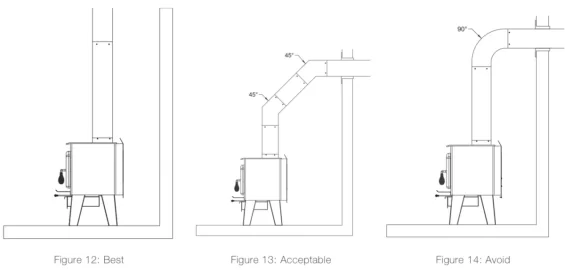

I’m thinking about getting a new stove in the spring, and I’m seriously considering a BK Princess. They have good reviews on here and seem like a good stove.
I’ll tell you about my chimney setup right now, and how I’m going to change it to be better in the spring.
My chimney is 6” flue. Right now it comes off the stove and goes up 3’. Then it hits a 90 and goes through the wall. The horizontal section is long, 4’. It then hits the tee outside and goes up 21’. The inside pipe is single wall stove pipe, and everything through the wall and out is Dura vent triple wall.
Changes I’ll make in the spring. I want to move the chimney closer to the house. So instead of a 4’ horizontal run it should be cut in half. Also I want to change the inside single wall stove pipe to double wall. I’m waiting until I get a new stove to make that change.
Do you see any issues running a BK Princess with this setup? From what I’ve read the min chimney height is 15’, and I have 21’ outside. Also I believe the vertical stove pipe height above the stove must be over 18”, and I have 36” before the 90. I do have a damper installed in the stove pipe, but maybe I wouldn’t need that with the BK?
I’ll wait until spring to buy the new stove. I’m hoping to get it and make my chimney changes over the summer, to be ready to heat with it by next winter.
Oh and I almost forgot. The house is around 1400 sq ft. It’s newer construction and I’m working to make it tight. There might be an addition in the future, but total footage shouldn’t be over 1800 sq ft.
Current stove is a VC Encore. Older everburn model. Things I want out of a new stove. Longer and more consistent burn times. Something I can set and forget while the wife is home and I’m out doing stuff. The VC everburn is finicky
I think it should be ok if you have the horizontal run shortened to two ft.
For Each ft of horizontal run you should add 2 ft to the required 15 ft height. For each 90 elbow you should add 1 ft to the required length.
So, for 2 ft horizontal and 2 90s, you'd end up needing 6 ft added to the 15 which is 21'.
Change the inside 90 to two 45s for better performance.
You should be fine, especially if you change the 90 to (2) 45's, when you do the outside work, you may want to consider building a chase to cover the majority of the chimney, especially if its facing the north side of the house.
The proposed changes will help a lot. Due to the cooler flue gas temps after the cat, the stovepipe should be double-wall inside. 4' horiz. is not good, the shorter the better. Inside the 90 should be replaced with a pair of 45s and an offset.

I’ll definitely move the chimney closer to the house. It’s setup right now to clear the eave. I didn’t have time to go up there to cut a hole for it to go through before winter.
Is the chimney chase just to protect the chimney? It’s on the south side of the house. The winds we get here are from the north quite a bit. I put the chimney on the back side of the house partly because I’ve heard the creosote will eat the metal roof. So I figure most of the time the smoke is blown back away from the house.
I like the idea of the two 45 bends versus the 90, but my wife thinks it’s ugly. I mean honestly she thinks the whole woodstove sticking into the room is ugly. But of course she likes the basically free heat it gives us.
With the chimney moved closer to the house, maybe I could get away with keeping the 90.
I have noticed with the 4’ horizontal run the creosote builds up in that section more than anywhere else. I inspect (and clean if needed) the chimney and stove pipe about once a month during burning season
I haven’t looked at the spacing requirements for the princess, but maybe I could tuck it even closer to the wall than my current stove.
Right now I have rock board behind the stove spaced off the wall with 1” spacers, and a 1” gap underneath. My plan is to put some kind of thin stone or brick up on the rock board.
So do we think the princess is big enough for my house, even with a future addition?
The stove is large enough for your needs (additional built to code will be better insulated then the rest of your house) The 45's are pretty important to how the stove functions, mainly when your opening the door you dont want to get smoke roll out, also flue temps are much lower when the stove is cruising along, lower temps mean more of a chance of smoke particles condensing, hence the chimney chase to add a little more insulation then just a bare pipe.
Function over form here. If she thinks that's ugly, what is her response to the Princess?

The point is that two 45s are going to keep your indoor air quality better when you reload...

Building the chase around the stack isn't such a bad idea. Holding stack temps on modern (2015/2020) wood heaters is a plus. Also, the clearances on the Princess to combustibles is only 6", so you should be able to get it close to the fireplace/chimney/wall. Also, the PE32 is 6" deep, so she won't mind the less frequent cleaning out of the stove. Once installed, it will "fit".
