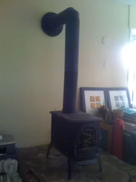

I live been living in a condo '70s era building for five years (800sf) with a VC Aspen/1920. It has a dumb stove pipe setup with 2 90 degree turns to an existing built-in chimney. The stove has never burned well and is always clogging - I won't even burn above 25 degrees. My chimney sweep has always shaken his head and attributed it to the poor draw/double turn. (I even clean my interior elbow as needed between his annual cleanings.) This year he declared it "not to code" b/c of a single wall pipe too close to the wall, and advised to replace the stove. I know it's never worked right, and always asked what I could do to fix it. I don't doubt it's not to code, but I would have replaced it years ago! (He is a PE dealer.)

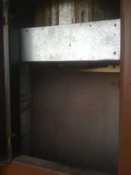

When you say "clogging", are you talking about the stovepipe actually building up enough creosote to where it restricts the flow of flue gases? What are the symptoms you experience that tell you your stove is "clogged"? If there's a single-wall stovepipe component closer than 18" to a combustible surface, then it's not to code. Was the chimney structure originally designed/built to accomodate solid fuel-burning appliances? I lived in a condo for 9 years. It had a pre-fab ZC fireplace installed in a masonry (facade) fireplace/hearth structure, with a metal flue up through an exterior siding-clad chase. Is that the sort of arrangement we're talking about here? It's possible that the chimney flue isn't even approved for a solid fuel-burning appliance, but was meant for a gas log sort of thing, dunno. Some more info and some pics would sure be helpful. Welcome to the Forums! Rick

It looks ok to me . I think you should have some masonry around the thimble . Your stove mite be built for a smaller flue . Is the chimney the same size of the flue? The chimney mite be to low if you are on the top floor. I cant tell what the 2nd picture is ? The stove look nice .Is it air tight? If the wood is wet it will not burn good .The elbow is not the best thing but if i told you I had a friend that had a old farm house with a stove pipe that snaked thru a hole house 1st 2nd and 3rd floor thru all the bed room walls from floor to floor hanging from wire. Im talking about 60 or 70 feet of steel pipe with about 15 elbow. My brother-in-law has a set up like yours and he has to clean it a few times a year. Ask the sweep what is no good, he mite just want to sell you a stove.
You could try the stove with about 3 ft of pipe, a 45, then a diagonal piece connected to another 45 at the thimble. That should draw much better and is a cheap fix that will work with this stove or another.
But the first suspect here is the wood. It sounds like it's not well seasoned. If that is the case, no stove will be an improvement.

If you can put in your own chimney it would fix a lot, maybe everything. If the pipe config is wrong then a new stove wont do any better than what you alredy got.
if it can happen, id fix the pipe config first.

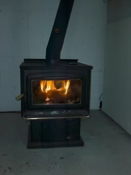

I think the stove pictured above could benefit from a stove pipe arrangement like this:
You can't see the upper end of the stovepipe, but it has a 45 deg. elbow, then goes into the wall.

I was thinking of the Pacific Energy Vista. But go ahead with your plan and change the piping. If it works well, you're set. If not, well, the new pipe will work just fine on a new stove.
