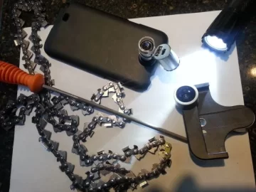

This morning I decided to make a little research on my own, and use my new macro and microscope lenses for my smartphone.

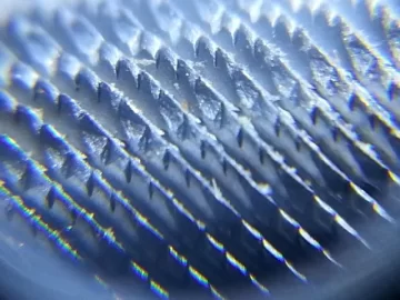

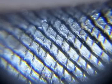

I started with putting the brand new file under the microscope
[Hearth.com] Is there a reason to sharpen a brand new chain?
and a slightly used file
Can this be a reason why people think a brand new chain is the sharpest it ever will be in its life time??

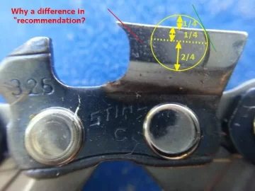

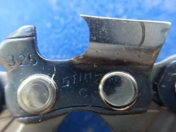

Then I checked out a brand new cutter link and compared it with a brand new one which I re-shaped so the edge fitted the file, and I found out that this brand new chain have a severe hook edge, which of course, makes the chain sharper when brand new, but also get dull faster.
My green line shows the "proper" edge angle after using the file, and the red line shows the "hook" angle from the manufacturer.

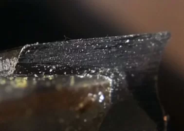

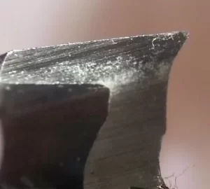

Now I took a couple of close-ups of a brand new edge...
and one that I gave a "reconditioner" with a fresh file
Now I let you guys make some comments...>>
Without a doubt it appears that the hook of the tooth from the factory chain is more pronounced. I don't know that I would call it a "trick" though.
May I ask what type of chain this was? RS/RSC or some other? It would be interesting to know if ALL of Stihls chains are sharpened to the same shape from the factory.
I did not have the box, and I don't know if there is a "code" or if the chain design can tell...
And I must say, that the one I adjusted with the file, still had little to much of a hook.

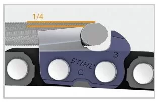

It is recommended to have 1/4" of the file diameter above the cutter plane, that will always make the proper hook size, usually 75-85 deg is rekommended.

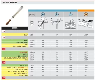

The image is captured from The Stihl Manual for sharpening
http://www.stihl.com/p/media/download/sharpening_STIHL_saw_chains_0457-181-0121_02.pdf

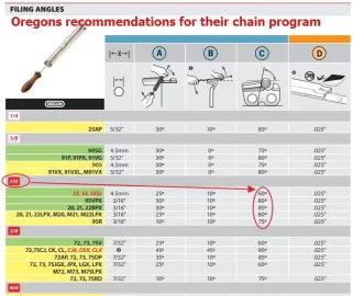

Oregon recommends 60-90 deg depending on the type of chain.
from
http://www.oregonproducts.com/pdfs/FilingAngles.pdf

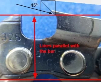

Back to my post. I can see that Stihl (which I love dearly as a Stihl chain saw owner), are giving counter active messages with their offficial
chain maintenance versus their design of the cutter. Why the f**k do they manufacture a chain with a 45° leaning edge, and then advice the user to change it to around 75° (thats what you get with ¼ of file diameter above the cutter plane) when sharpening with a file???
[Hearth.com] Is there a reason to sharpen a brand new chain?[Hearth.com] Is there a reason to sharpen a brand new chain?
I do not take a lot of brains to see that something is wrong here...or does it?
If we keep maintaining that 45° when sharpening, we will be called to have used too small file diameter by the "real experts"
Finally I do think Oregon's experience in this chain saw subject is pretty solid.
