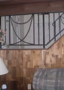

This is my setup for getting the heat upstairs. The stove was purchased for the downstairs family room, but any heat that gets up the steps will be a bonus. Here are some pics taken from the fireplace and from the foyer.
