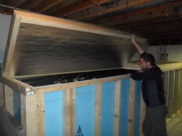

Yes, you can certainly add heating coils to large storage tanks.
However, a well insulated large storage tank will take some time to freeze.
With regards to insulating these tanks we have found that 1.5" tuff R foil faced insulation works great!
We are located in East Jordan MI and have several Effecta boiler customers using this method.
I have attached some photos to this post for everyones review.

When I installed my outside storage tank, I built a heavily insulated enclosure around it. I calculated that if I heated it to 160 degrees on November 1 and then went to the Caribbean for the entire winter, it would never come close to freezing. The house might freeze, but that's a different issue.
I would think that if you put your tank in a place were you seriously were worried about it freezing then I would question putting storage in that location to being with.
Why loose all those BTUs?
