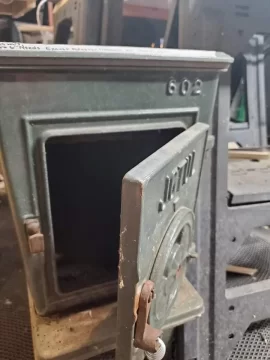

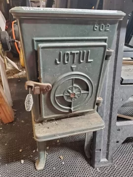

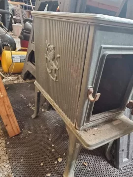

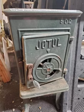

Hey all. I ran across this 602 on Facebook. Asking price is 200 obo. I looked it over, and it looks like a project, but not to tough. Ive never seen it in person. I would like someone with knowledge to give me their input. Thank you.

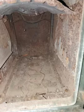

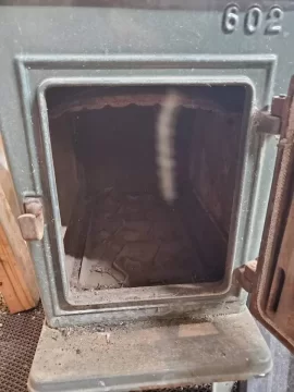

Looks like the internal burn plates are toast. Probably not worth $200 if you want to restore it for use.
The picture of the inside the stove looks like he right burn plate is missing. This stove still looks like it has some live in it so it all depends on what you are going to use it for. If you keep a close on on Facebook Marketplace you can sometime get a wood stove with a better secondary burn system. I have even seen some nice stoves for $50.00 but you have be the first one to see the add.

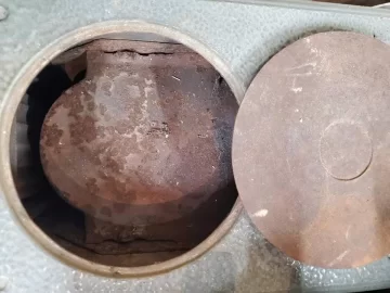

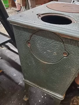

I see both burn plates are there. Just hard to see in the one picture. And they dont look too warped, they should clean up. And there are no external cracks that I see. The baffle has a crack in the back, but those are cheap on woodsman. Your missing a handle, you can get that on woodsman too. And your missing the flue adapter, again, available.
All in all, if you are planning to fully restore it too keep it, its not the worst by any means. If your trying to restore too sell, id try to get it cheaper.

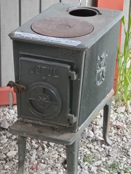

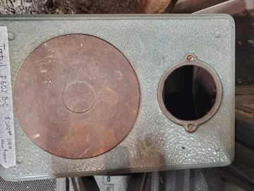

Looking at the pictures again, they have it mis-labeled also w the masking tape. Its just an old 602, not a “F602”cb”” two completely different stoves, with completely different burn set ups and internals. The f602cb is well over 1000 new, but this 602 has not been sold new in almost 25 years. And is worth much much less than a F602cb.
[B]Deranged Hermit[/B] thanks for pointing out my misreading the pictures. When I looked closer I could see the other plate. Hope Beeffarmer finds what he is looking for. This is the first time I have seen pictures of the inside of a Jotul 602 . It is very much like the WoodFord I rebuilt sometime back.

Yea the internals of these old vintage 602 stoves are as basic as they get. Just a couple burn plates to protect the sides, and a baffle to reflect some of the heat back down to make the stove a little more efficient.

Needs some work, but not a bad place to start from. Offer $150 and see if they will accept that.
