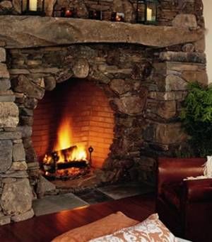

I am not home right now to get a picture but the fireplace looks very much like this...
[Hearth.com] Is this a bad idea?
Maybe a little bit bigger but exact same shape and similar stone. Our problem is that the smoke shelf is way to low, you can see it about 1.5 foot before the top of the circle.
I believe that the previous owners had some type of metal glass front and changed the firebox and smoke shelf to fit this front they had :(
We have seen historic pics from the 30's of this fireplace in use so i know it's possible, but you could't really tell what the firebox looked like from the pics.
Very cute. Looks like a fireplace fit for hobbits. If you can post the early historical pics with it burning that would be good.
What do you mean you can see the smoke shelf? that is typically above the damper i think we need to see pics of this
Yes, something is amiss if you can see the smoke shelf. Somebody who didn't know what they were doing reconfigured that fireplace. As I said, sounds like a good candidate for installing a metal piece to block the top, front of the fireplace opening, and if you do, I bet the thing will draw properly.
Well we need to see pics find out what size flue what the smoke chamber looks like ect before and more speculation. If the design is as bad as it sounds it might not ever work well. And if you do have it fixed I have a feeling you are going to spend allot of money
