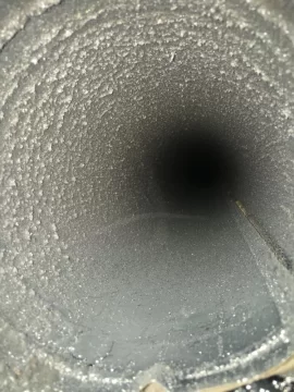

I'm new to wood burning. I'm currently running a summers heat 50-shssw01. I have kept my propane furnace from running often but I checked my stove pipe and flue today and am wondering if the is a lot. I will admit that my wood is subpar. MC 25-32% mixed with pallet wood and seasoned cordwood with MC of 15-18%

I’m not a pro, but you’re looking pretty good there. Looks like dry powdery stuff, which is good. I’m guessing this is the bottom of your setup. Can you view the top safely? Top is where you would be more apt to develop creosote.
Is there some shininess to the pipe there? It could be just the angle of the pic, but wanted to ask. Shiny creosote is problematic.
Not bad I’m burning unseasoned wood to moisture content of 20-30 % after a month a half of burning without any mixed seasoned wood or pallet wood I had about a sandwich bag and a half full just clean the chimney once a month you’ll be alright
I forgot to mention this is after 1 month of almost nonstop burning. The roof is steel with a 8 or 9/12 pitch. Not exactly easy to get up and down
Anyway u can clean it from the bottom up that’s what I do with mine as my roof is steep and high as well so I do bottom up than go up top and make sure it’s good sometimes I just use one section of handle to clean the top if it needs a little extra love
8/9 pitch ain't bad. Make yourself a chicken ladder.
Stack don't look so bad. Check it monthly just to be sure it doesn't get real bad.
Looks pretty good. A lot of use the SootEater to clean from bottom up. The cap is almost always the worst. You can use binoculars to tale a peek without getting on the roof in the snow and ice.

I'd say given your sub-optimal wood supply, some of which is 25-32% your looking pretty good. If that's the best wood you have, I'd clean it mid winter. In a perfect world I like to have my firewood sub 15%

I also have an England Madison ( summers heat 50-shssw01 ). My first year I was burning fresh cut green wood. At the end of the season, I had about a ziplock sized bag filled with creosote. I bought a soot eater and clean the stack from the bottom up. Yours looks about how mine did when I checked it after a couple months.
