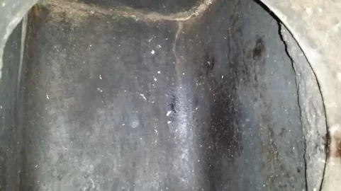

Chimney inspection found this crack only. The chimney sweep said they need to rip out all of the clay liner to the tune of $2500 to take it all out and line with a flex liner.
The location of the crack is directly on the tile or section were the themble commects to the stove.
I was thinking of putting an liner in but do I meed to break out the clay?

You don't need to bust out the tiles if an insulated liner will fit. What are the inside dimensions of the clay liner?
And what is the height of the chimney?
It likely does need re-lined, if its cracked right there its also cracked other places. Most often the crack continues the length of the flue. Occasionally the clay needs to be removed, but not very often. Most of the time an insulated stainless flexible liner can be pulled down without removing the clay.
Chimney sweeps are kinda notorious for a big bill to re-line a flue. If its under 25', you should have no issues getting it done for $1500 or less.
that looks like a 7 by 7 inch liner to me which usually does need broken out in order to get proper insulation in. Like others said what is the height of the chimney? $2500 might be overpriced might not be depending on the type of liner and the height of the chimney. And by the way breaking out is not that big of a deal and usually doesn't add that much to the cost of the job

Small crack right where the pipe blasts into the tile. No sign it extends to the tile above it. On the other side of the chimney away from any framing members. Located where the tee will be.
I wouldn't knock out those tiles until a camera is run down that chimney looking for any other cracks or compromised mortar joints.
I planned on putting a liner down it. The guy with the higher estimate used a camera and said the only thing he could find was that crack. I thought maybe I could just use this chimney as is but the more I read the better I am feeling about putting a liner in it. I dont think I will be taking the tiles out especially because this is the only crack that could be found.
It really should be insulated. But that isn't gonna happen without removing tiles, in fact it would be hard to get a 6" liner down unless those tiles are aligned almost perfectly. They usually have a fair amount of difference from top to bottom.
