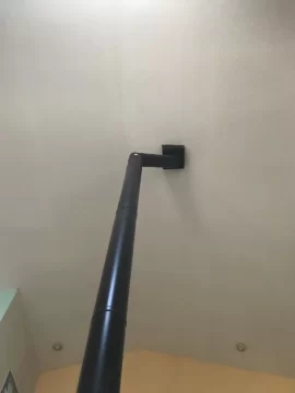

I'm no CAT expert, but aren't your flue gasses about room temperature by the time they get to the chimney?
How many chimney sections from the support box to the top??
Is that stove capable of putting that much heat up that pipe to create enough draft to prevent smoke roll in when opening door?
Good point. Cat stove flue temps vary but they are often over 300F. It's strongly recommended to use double-wall stove pipe for any run over 8ft and doubly recommended for cat stoves due to lower flue temps.
I think that's 20 feet of condenser, I mean connector pipe.

IHow many chimney sections from the support box to the top??
It’s 5 sections of pipe. I have no idea how hot the pipe gets at the top but it’s too hot to touch as high as I can reach. As long as the flue is open, smoke does not roll out when I open the door. But smoke does occasionally leak out from the side door around the worn gasket and the inlet shutters.
Good point. Cat stove flue temps vary but they are often over 300F. It's strongly recommended to use double-wall stove pipe for any run over 8ft and doubly recommended for cat stoves.
I found a small section of extra pipe in the closet - see pics. Is this considered double-walled?
That’s double wall. It’s dura-vent DVL
