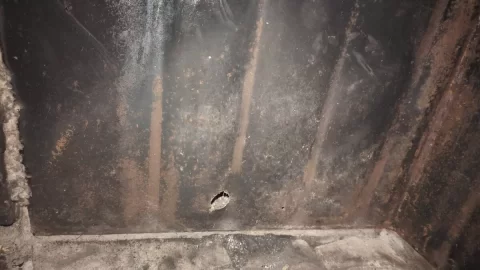

Hi all,
I recently purchased an older home that had the wood burning fireplace converted to gas. I had it inspected to ensure it was safe to convert back to wood. I have removed the gas line but, I don't know how to fix the hole left behind in the metal insert.
[Hearth.com] Is this hole repairable?
Is this a Zero Clearance fireplace or a heatform style (aka heatilator) metal fireplace?
weld a plate on
Depends on the thickness of the metal and whether this gets covered with a refractory panel. If it's a ZC with sheet metal under refractory then the metal may be thin. In that case pop riveting a patch may be easier and better?
The metal is about 3mm thick and doesn't have refractory panels. I'm not sure if it is Zero Clearance fireplace or a heatform. I'm thinking welding in a patch may be the best option. I'll attach a photo of the exterior.
It looks like a heatform style with the lower intakes and upper heat register. Welding is fine, so would screwing a small plate in place work.
