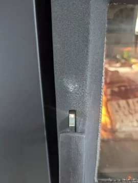

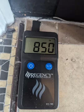

Installer installed the Regency CI2700 today and started the first fire ~3 hours ago. The flue is a 5.5" stainless 316L flex liner, 42 feet long (tall chimney!), and insulated with Thermix because there are 2 offsets that made it impossible for them to get the insulated liner down (they tried once from the top and once from the bottom).

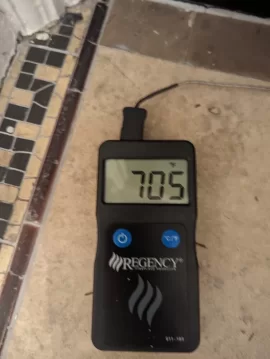

The room was pretty smoky the first hour they fired it from the paint curing, and the curing smell is lingering. But its only been a few hours so I'm not worried. But I did notice a few discoloration spots and wondering if this is normal? Is this a sign that it was overfired (I attached the current thermometer reading, the max it got to was ~900 if I remember correctly... this is the therm that came with the unit so I think it is a cat therm?)? Can I just touch this paint up?

Have your installer come back out & touch it up. Grab a can of Stove Bright Metallic Black for future touch ups. Metallic Black blends very well with previously painted surfaces.

Sounds good, I'll pick up a can and ask the installer to touch it up. Is it likely because of going too hot on this first burn?

42 ft really is tall. Over firing is a real risk because of too much draft.
Insert so I assume no damper?
Close the air soon after reload... (@begreen can help more with when)
Where is that temp measured?

It is going to overfire with a 42' chimney. I put dampers on these over 25'

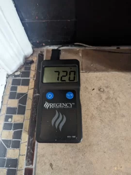

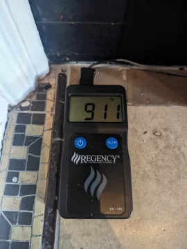

Temp is measured using the provided thermometer that is wired into the unit.. so I'm guessing it measures at the cat?
I reloaded with 3 splits. Opened air intake and cat bypass as they suggest. It was roaring quickly so I closed both the air intake (all the way) and bypass within a few minutes. Highest I saw it get over the next hour was ~1050.
And now we're at a new high temperature so some more curing smell is happening.

It is very important for you to know that it in fact IS the cat temp. Because cat temps up to 1500 or so is fine. Any other place on your stove it would be highly problematic.
So, does the manual say anything about the thermometer that is delivered with the insert?
Reactions: north-east-colonial
It is a digital cat probe
Regency brochure says "Digital catalytic temperature monitor helps your stove reach maximum burn times & efficiency"
so it's a cat therm
Reactions: stoveliker

Correct. The tall flue will have a draft higher than the stove mfg specs for the insert. As a result your insert will suck in more air than it was designed for. That will make the primary fire burn hotter. This leaves less fuel (smoke) for the cat. And it makes the gas flow through the whole system faster, leading to a shorter residence time for the gases inside the cat, so the cat won't be as efficient in combusting any residual fuel in the gases. And thus the cat could not get as hot as it would otherwise (and your insert might be hotter).
I have a cat stove, and often the cat temp *rises* when I decrease the air. (Because: less flame, more smoke, and that's the fuel that the cat converts into heat.)
edit: burn hotter AND faster. You won't get the burn times one could get with the stove.
And because of the hotter fire and faster gas flow, you'll be dumping more heat in the flue rather than in your home. So you'll be burning more wood for the same heat as you would with a properly installed (to draft specs) insert.

It is to much if your chimney is 42' absolutely no question about it

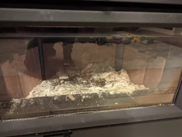

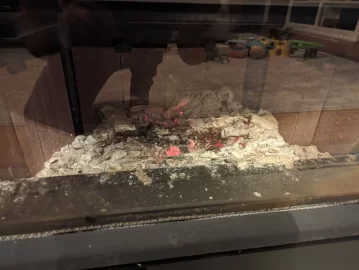

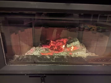

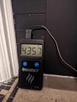

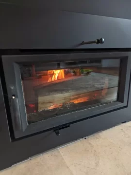

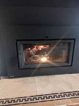

6:30 - loaded 3 splits with plenty of room leftover in the box, cat temp 720 after reload
6:43 (t+13m) - fire roaring, cat temp 911, close air intake and bypass
7-7:30 - observe cat temps around 1050

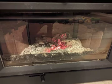

9:20 (t+2h50m) - cat temp 705, no active flame and logs are mostly gone, lots of coals left

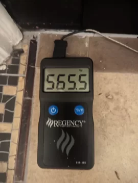

10:10 (t+3h40m) - cat temp 565, not a lot of coals left

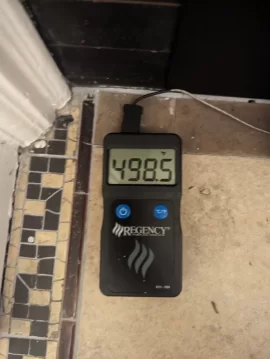

10:40 (t+4h10m) - cat temp 499, not a lot of coals left
11:10 (t+4h40m) - cat temp 436, a couple of coals and not much burning embers visible
-- no more pics --
11:40 (t+5h10m) - cat temp 379, same coal situation
12:30 (t+6h) - cat temp 320, very small coal ember barely visible
