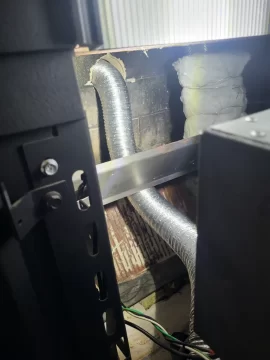

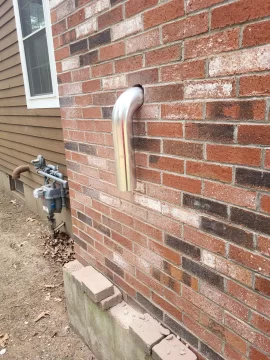

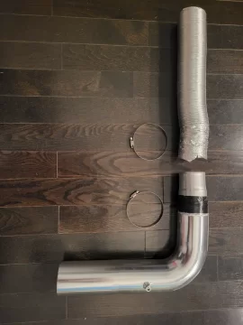

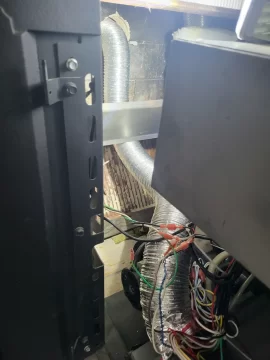

Thank you. Just finished the job. Working fine. Saved lots of money using scrap parts in the garage.
Total cost : I paid some guy off Craigslist 75 bucks to drill a hole with a SDS Max 3.5" core bit carbide tips.
